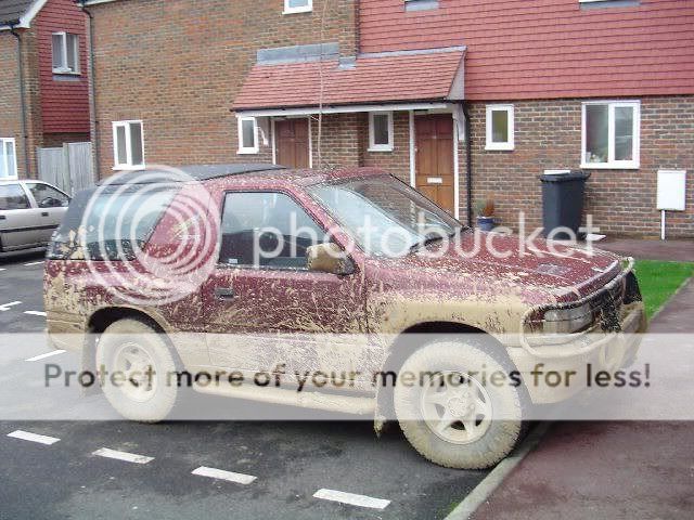

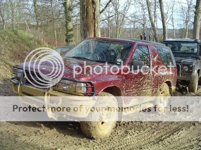

The pay and play days are great fun.
Heres a couple of pics from a few years back when i took the wifes Frontera out for a day...... she was not happy when i got home lol!

Ha ha, Cool i bet she kicked your arse lol!

Lovely mud.........
I bet she was ever so slightly miffed....... oops
How did you find the Frontera.......chap at work has one......poor sod had nothing but trouble with the Engine management system..... No

She was not a happy lady..... Slap
The Frontera was a great little tool off road.
On road it was not my cup of tea, but she loved it. The only problem i ever had with it was a snapped cam belt (about a week after the play day Escape ) This was a 5 min fix so not a biggie really. Had it 2 years and sold it for more than i bought it for. Was a right little bargain Driving
