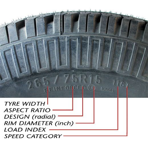

Modern (e.g.235/85 R16)
235..........the width of the tyre in mm
85............the % ratio of sidewall/height
R.............means the tyre is radial construction
16 ..........the diameter of the wheel rim in inches
Tyre Index Tables
SPEED CATEGORY TABLE
INDEX MAX KPH LI KG LI KG
G 90 N 140 T 190
J 100 P 150 U 200
K 110 Q 160 H 210
L 120 R 170 V 240
M 130 S 180 W 270
LOAD INDEX TABLE
LI KG LI KG LI KG
97 710 107 975 118 1320
97 730 108 1000 119 1360
98 750 109 1030 120 1400
99 775 110 1060 121 1450
100 800 111 1090 122 1500
101 825 112 1120 123 1550
102 850 113 1150 124 1600
103 875 114 1180 125 1650
104 900 115 1215 126 1700
105 925 116 1250 127 1750
106 950 117 1285 128 1800
