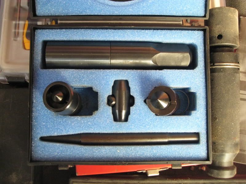

but the best by far is the proper kit (ok I didn’t pay for mine – a perk from a job)
the other is the reverse threaded socket that is .5mm bigger than the size you need and then tightens up when undoing the nut , here’s some picture to help explain ( I hope). As you will see the Pukka kit has never been used...

to be honest the pukka kit is the nuts, first you centre punch the locking nut, then the cutter tool goes into the handle and you add the inpacket driver and hit it so it turns and cuts into the locking nut undoing it.
But for easy of use the threaded socket is so quick and easy.
