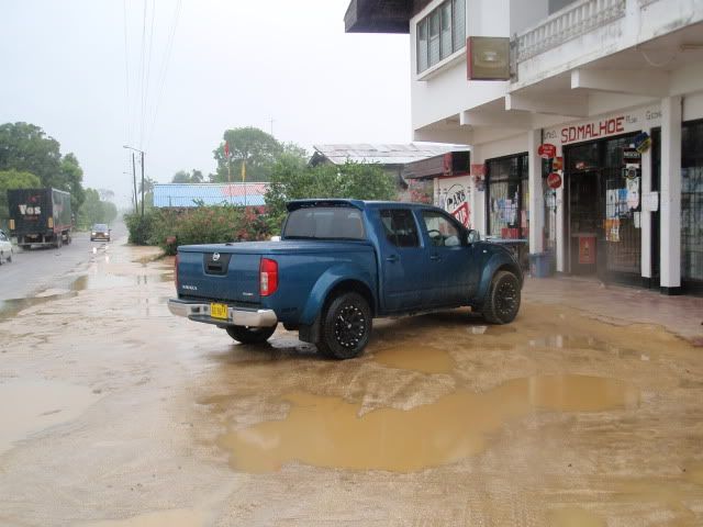

Here are some recent pics (yesterday, actaully), with the new projector headlights.

And here some details (bottom to top): The outside air intake for the Apollo II intake (sealed from the enginebay on the inside), 18" KMC Addict wheels, Zenith Autosport (Thailand) rear wing. I haven't come across another Nav with this wing, and I'd like to keep it that way, to be honest...
